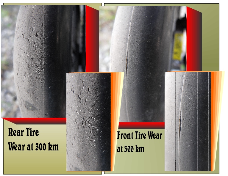

Postby Stevbike on Mon Aug 09, 2010 7:27 pm
Here are some pictures I took of the tire wear on my 8" wheeled A-bike copy. This at the 300 km mark.
A-bike tire wear.JPG (233.11 KiB) Viewed 22195 times
